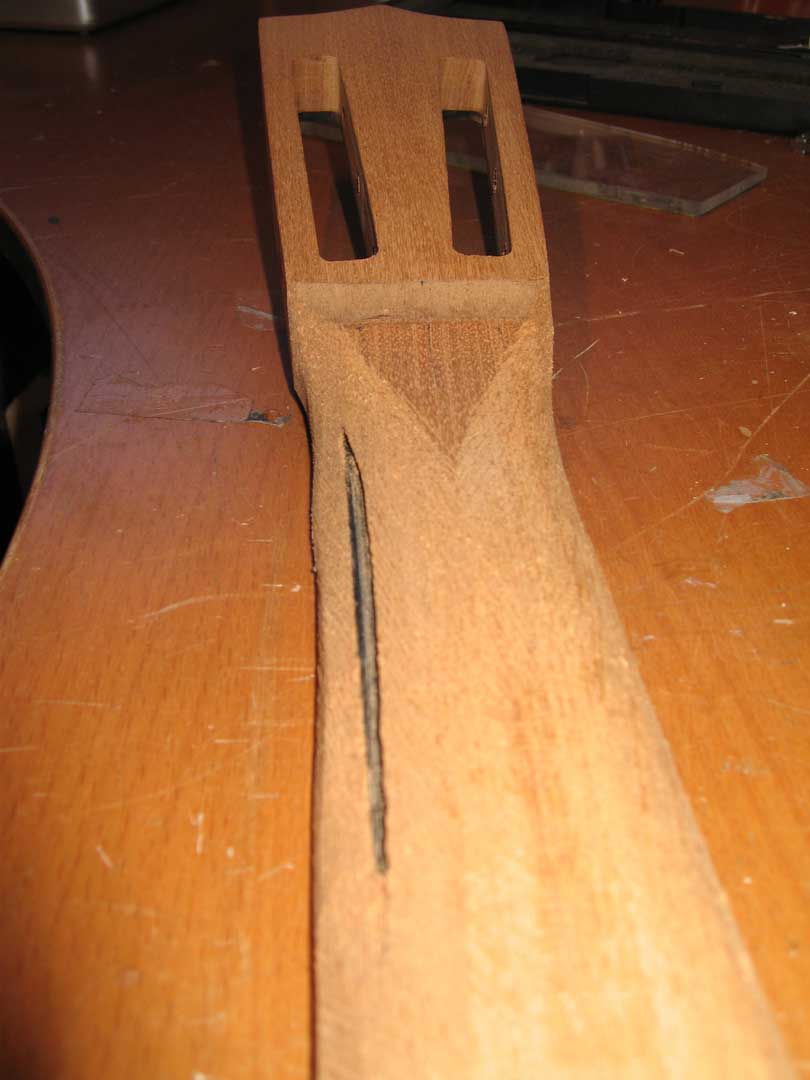

I just proved that I am still an NEWBIE!!!!!
This was the first neck that I used carbon fiber rods. Well, I guess you just
cannot place them anywhere!!!!
The freboard was on and leveled via tape as described in a previous thread.
Removed and fretted. GLUED on. All I needed was to carve the neck. I do
this with rasps. Well WOOOOPS...I carved right into the carbon fiber rod!!!!!
I thought I was going to puke!!!!! I assume this is not fixable. I have already
used my heating blanket to carefully remove the fretboard. I guess it is time
for a new neck. I TOLD YOU SERGE I STILL DESERVE THE NEWBIE STATUS
UNDER MY NAME!!!!!

Don't be too hard on yourself, this sort of stuff happens, and we live and learn, Not really fixable without it showing, or at least I don't know how.

Andy, Just a thought before you terf that neck. You can use autobody filler to fill around the CF and plug the grain in that part of the neck and finish it black for some other guitar that you plan to do a dark burst on or something. A concern with that is how well the adhesion between the CF and the wood is and whether going through to the CF will weaken the neck too much. I have not used CF so don't know. But just a thought on some salvage.

Don't feel bad-there was an article in one of the trade magazines were a very famous luthier did the very same thing and fixed it by inlaying pufling over it and making a design that he now uses as a design element.
I am not implying that you do this just trying to make a point that it happens to very experienced people as well.

Andy, It seems your CF rods were a little far out from the truss rod?
I do mine a little bit tighter, or so it seems
What you might try to do is cut that neck in 3 pieces and glue it up with two color lam's right where those rods are now. Then reshape. Just a thought, probably more work than what its worth.

A few questions from your pic. What are are cross sectional dimensions of the CF? How far from the TR were the slots routed? It looks kinda close to the edge where there's less meat.
From the pic, (slothead) it looks like this is a 12 fret neck. I've only installed CF in longer electric necks and 14 fret acoustic necks. My rationale is that the shorter neck will be stiffer and may not require the addition of CF. I'm sure others will have better info.

Clearly my rods were to far away from the truss rod.
No it was not a 12 fret. Just a 14OM were the client wanted a slotted
headstock.

Wow, it's like deja vu all over again. I did that exact thing on my first neck. I started seeing a darker line that I thought was a pitch pocket so I kept chasing it out and it got bigger and bigger. Until I realized...
From your photo it looks as though the CF rods were not seated all the way to the bottom of the slots. Is that what is going on there? If so, in the future, you'll want to fill that void with epoxy before you put the carbon in. Voids in necks are not a good thing. If it's not a void, well then never mind.

The bondo idea seems like a good one to me. I don't think I'd trash it just yet. This project gets a new blank!

It was Ervin Somogyi. He exposed the truss rod. His solution was to glue in a long strip of mahogany down the center, and hide what would have been noticable join lines with a very creative purfling design. To his surprise, prospective customers either saw or heard about it and wanted that on their guitars. It's become somewhat of a trademark on his instruments. Lemonade from lemons!
